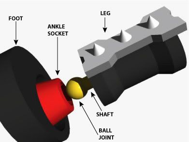

Thanks for the info on Gabrine. For those that had problems, could you please tell me where the problem area is? I made up a quicky 3 D render of what I can tell of the leg and foot parts. Is it the yellow ball joint that has the problem or the red socket part of the foot? Is this drawing even accurate? Thanks for the input.

Either the socket is too small or the ball is too big.

Benio wrote:Thanks for the info on Gabrine. For those that had problems, could you please tell me where the problem area is? I made up a quicky 3 D render of what I can tell of the leg and foot parts. Is it the yellow ball joint that has the problem or the red socket part of the foot? Is this drawing even accurate? Thanks for the input.
Mine broke where the shaft meets the ball joint. I believe SD's right that the ball joint is too large for the ankle socket. Hence it getting stuck.
I tried Xehn's idea, got the ball joints to move so the feet are straight now. However getting the two pieces to glue together is proving difficult. Crazy Glue takes too long to set. Any suggestions for a fast drying adhesive I could try?

ShadowDragon wrote:Either the socket is too small or the ball is too big.
Sorry if I was unclear, but I was wondering if the damage was to the ball joint or to the socket.
Deviant Anomaly wrote: Mine broke where the shaft meets the ball joint. I believe SD's right that the ball joint is too large for the ankle socket. Hence it getting stuck.
Yeah this is what I wanted to know. Thanks DA. Maybe you can use a small, thin piece of metal (like a paperclip) for added structure to attach the ball to the shaft. Or if you can get into the leg (if it disassembles) maybe a small screw can be used to attach the ball to the shaft. I'd really have to look at the leg part to see how it is constructed.

I echo drilling a tiny hole in both pieces and using a paperclip or nail with the head cut off or something to stiffen the joint before gluing.

I echo the call for pinning it. It'll reduce the chance of it snapping off again later. Beyond that, I'd think some sort of epoxy glue might work out better in the long term, but there's a variety of 'quickening' agents for superglue. Those tend to make the join a bit brittle, though. You might want to see if you can find a vise or some other jury rig to hold the two pieces together until the glue sets.
